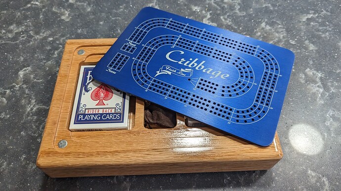

Cribbage Boards - Love how quick and accurately my OneFinity Woodworker cranks these out!
My Aluminum decks must be milled to very tight tolerances when marrying them to my wooden bases. All I can say is they “Fit like a Glove” when I get them off my 1F, the pockets are accurate and tight as well.
My customers love my Crib Boards and I’m just thankful I do not need to keep a ton of inventory anymore… just drop in the jig, run the saved carve file… sand… finish… ship. It’s awesome.

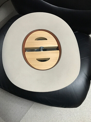

Sometimes it’s the simplest things…
I needed to shape my Stetson a little. :grin:

Mike is there a file for this?
Here ya go. hat stretch.dxf (43.8 KB)
Just something simple I whipped up after seeing them on line. I used 3/4" cedar for mine. I believe the mass produced one are 1" or 1 1/2" boards.
I drilled a 5/16" hole in both pieces and then a 1/4"-20 bolt with the head cut off and a wing nut for adjustment.
I wanted to make my lid more into a long oval shape to better fit my melon head :rofl:
Steamed it a little bit and it seems to have helped.
Thanks so much. I may try to put a threaded insert in there, as well, but figured you were using a treaded rod and the wing nut to expand it… So based on your pick and description this makes perfect sense.
Post a pic when you make one. :smiley:
