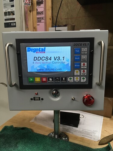

Yeah, on the controller… I was learning certain things about the controller I wouldn’t be happy with, so I decided to build my own. This is virtually identical to the one I built & used with my x-carve for 4 years, so I’m used to it.

May I ask what things in particular you found limiting or missing in the OF controller.

When I was looking more closely at the controller picture you posted I noticed a dimensioned drawing and black plates, and then on your OF it looked like there are plates under the four y axis mounts that raise it up about 1 cm from the metal base. Did you have these made and add them to get greater clearance for the x axis mount as it moves across the table? This clearance was one thing I wondered about on the OF as perhaps it would allow for debris to get jammed underneath during use.
There were a few things I’ve read, mostly pertaining to bit changes & not being able to jog after a program pause. I’m accustomed to full functionality & control after having used this controller for the past 4 years. Plus, all my existing programs will run on this controller.

Pretty much completed this weekend!

Thanks Larry! Had a bit of a struggle with the wiring, but worked through it today.
