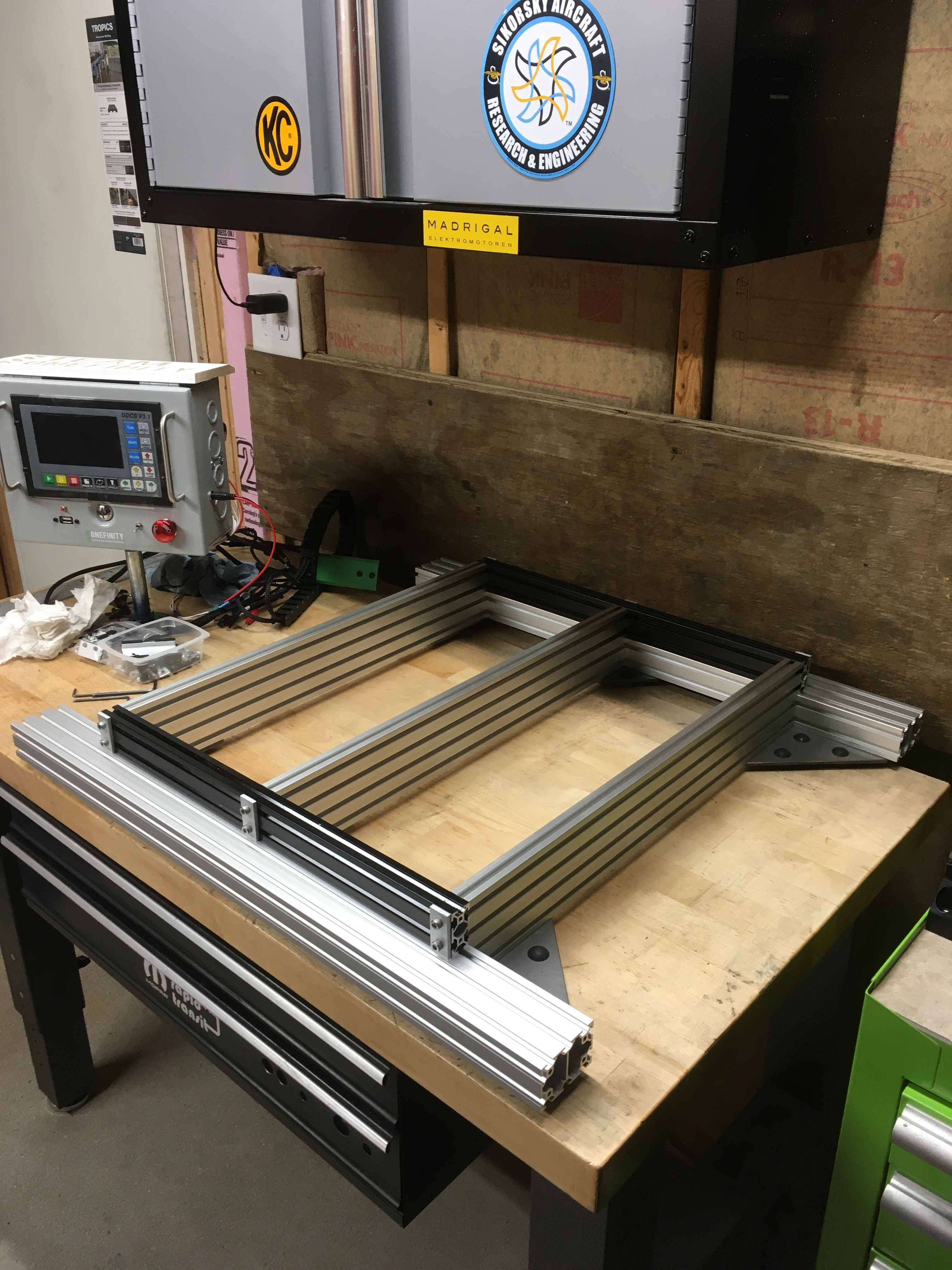

I got the frame materials today and did the basic assembly, will finalize it tomorrow.

Here’s the baseplate DXF. The extrusions are as follows:
40mm x 60mm x 712mm (2 pcs.)
20mm x 80mm x 550mm (3 pcs.)
20mm x 40mm x 477mm (2 pcs.)
OFBP.dxf (126.7 KB)

Additional hardware:
2-hole joining plates: 2 Hole Joining Strip Plate - OpenBuilds Part Store
M5 assembly nuts: Tee Nuts - M5 (10 Pack) - OpenBuilds Part Store
(you might find a 50-pack on Amazon, I think I’ve bought these before from there)
M5 x 20mm flanged socket cap screws (for securing Y axis blocks to the frame: McMaster-Carr
M5 x 8mm flanged socket cap screws: McMaster-Carr
M5 x 40mm socket head cap screws (no link)
M5 x 10mm flat head socket cap screws (for securing the steel plate to the frame)
Additional detail:
The 2 top holes are tapped in the 20 x 80 x 550 extrusion pieces. The 20 x 40 x 477 extrusions are drilled 5mm so they can be bolted to the 20 x 80 extrusions as shown.
The 20 x 40 x 477 extrusions are attached to the 40 x 60 x 550 extrusions (centrally located) by using the m5 x 8mm flanged socket cap screws, which nicely engage the lower slot in the 20 x 40 extrusion. There are 5mm allen wrench access holes drilled thru the top of the 20 x 40 extrusions in 4 places. This part is pretty tricky. See pic below for how this works. It’s not the exact application, but you get the idea of how it holds the frame extrusion in place. I would also recommend ‘trapping’ the t-nuts in place per the pic below. Otherwise, you’re in for a fight to keep things lined up while you tighten the screws. Securing the 20 x 40 extrusions to the 40 x 60 extrusions is actually an optional procedure, as everything will be sandwiched together by the upper work plate & lower angle plates.
I don’t have a DXF for the lower corner plates. They’re just 5" x 5" laser cut plates with holes for the rubber isolators. Unfortunately I don’t have a link for the rubber isolators, I got them from where I work, used on some of our products. I’m sure you’ll be able to find something equivelant that will probably screw on.
