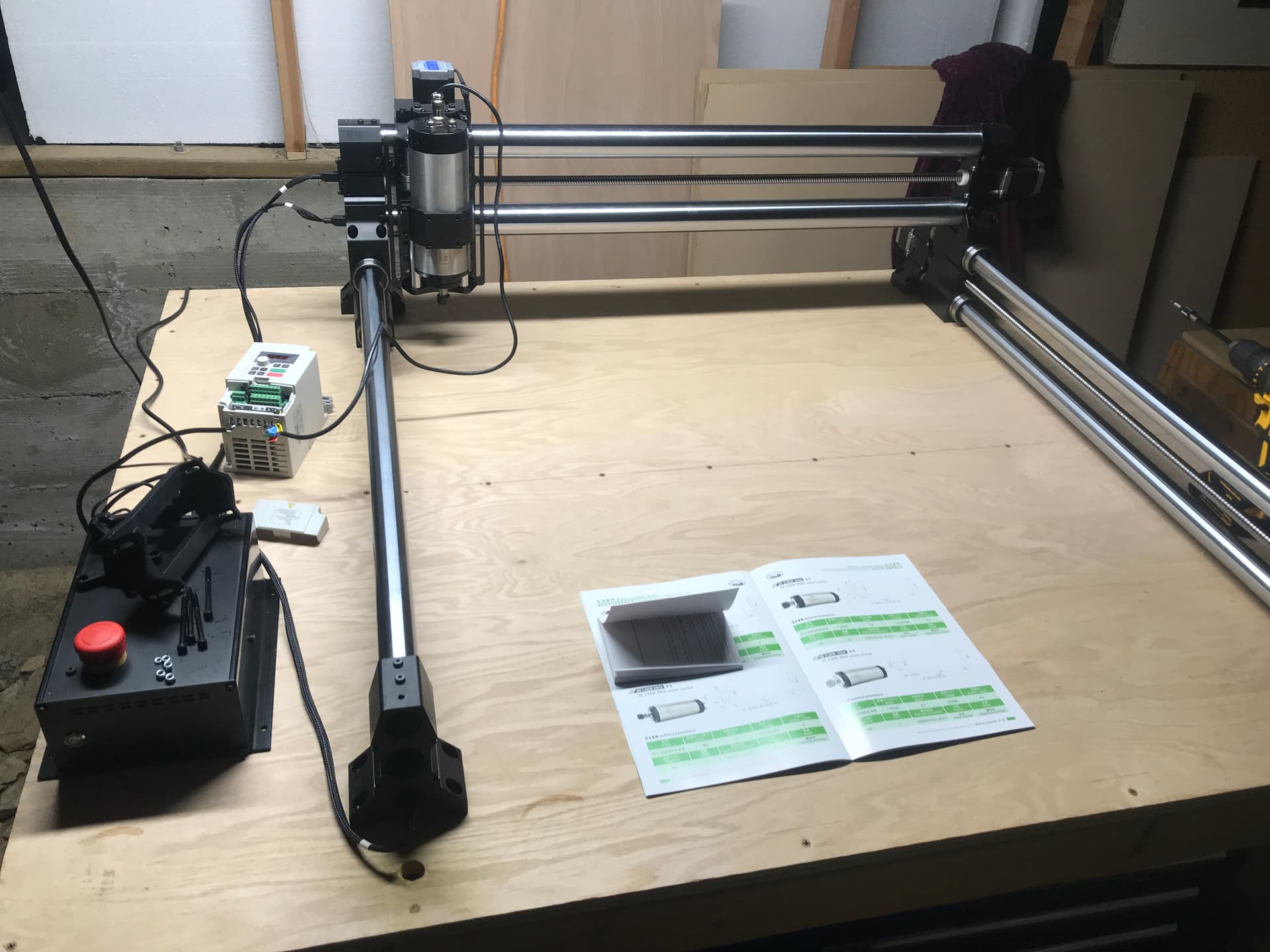

I have an 80mm spindle wc 1.5kw 110v system set up with my 1F.
I have set up the vfd parameters to the best of my knowledge and many videos…lol
I can press run and motor will spin up to 400Hz but the dial control on vfd does nothing for me.
This is a closed loop between the motor and vfd just to test out function and learn more before incorporating the 1F.
Any ideas, is this a bad vfd…?

Yes, I have been reading and re reading the manual.
The VFD is model H100-1.5S2

I was in error when I said that I did not read the manual. It seems to be the same VFD as in this thread from the other day. The manual, is it identical to this one?
If yes, have you set F002 to 3 and F001 to 0?

First of all, have you set the mandatory settings according to your spindle manual:
  1. Rated spindle voltage
  2. Rated spindle current
  3. Number of magnetic poles of spindle
  4. Maximum spindle speed
  5. Minimum spindle speed
As others have said you have to enable the knob before the VFD will recognize input from it. But there’s other settings you’re going to want to change. For example if it’s reading hertz for speed you’ll most likely want to change it to read RPM.
Thank you , the F002 to 3 is what did it!!!
As for the settings, I have input the poles 2, hertz 400, volts 110 etc for the 1.5kw 110volt 400Hz spindle motor. Big Thanks
