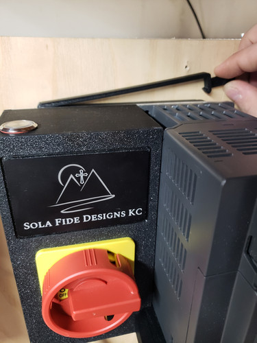

Hey Alfie,
regarding spindle and considering what @Echd said, I can say that one thing to consider is electrical safety of a setup, and setting up a spindle and a VFD, if not buying an industrial ready-to-use setup mentioned in my post here, is something that should be made by a certified electrician or that you should at least try to acquire partly that knowledge. It tried to provide a lot of information in this forum on building your own VFD enclosure, making a safe spindle cable or better buying one ready-to-use.
If you consider the Onefinity CNC, you also have to know that…
So in addition to judge critically on the stock cabling on the Onefinity machines, generally you have to take care…
  1. of the fact that a VFD is a device intended for installation in a grounded control cabinet that acts as faraday cage,
  2. to select a suitable spindle power cable and to wire, shield and terminate the spindle cable correctly (for this, see also this important document)
  3. that your entire CNC setup is properly grounded (see also materials and tools needed for this)?
…and that you have to pay shipping costs from Canada. We paid $650 to Germany for Original Series Journeyman ($325 for Woodworker) but with this it was sent using DHL Express and it was here within one week, which means this was an expensive shipping by air freight. We were not able to select a freight service on the order page though.
I did not want my upgrade to bring down the machine for days/weeks while I try to get whatever disparate parts I buy to all work together; too many Christmas gifts to make =]
IMHO: Hardest part of installing a 80mm spindle is sodering the cable :stuck_out_tongue_winking_eye: with one bad eye. Check out the Frankenstein Bench for more info also Myers Workshop How to and IOT Relay
