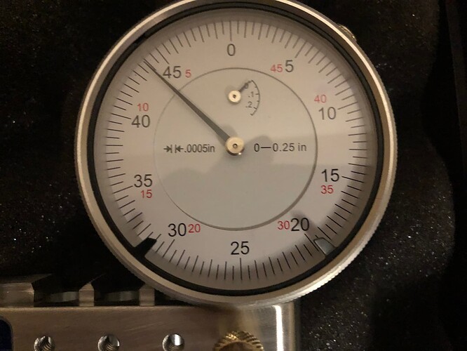

Having looked at the tramming tools at Amazon and having seen the bent shank on the unit shown above, I looked a little farther and found one that seems to be a bit nicer. The shank is a 1/2" blank with a 1/4" hardened dowel pressed into it. The dial indicators they use measure to .0005. All but the indicators is made in USA. “For a Few Dollars More …”
https://boringresearch.com/store/desktop-spindle-square/
I found this video quite helpful. OK I agree it’s fairly primitive but it works very well. Depends on what sort of accuracy you are looking for.
This arrived today from a company who’s name ya’ gotta’ love! “Boring Research.” The pictures do not do it justice. It is artfully made and has a really nice/secure case. Note the .0005 resolution.
Thats very cool looking. But why would you want two sensors?
It is a tramming gauge. the shank goes in the router/spindle and then you turn the device so one dial is on the left and one is on the right. You then adjust any left/right tilt out of the router until both gauges read the same (not necessarily zero). Then you redo the procedure with the dials front and back. Rinse and repeat until the router/spindle is as close to absolute 90 degrees to the work surface as you can get it. Legend has it that there was once a person who actually got his setup at exactly 90 degrees. His machine has been placed at Area 51 and he was seen being whisked away by men in dark clothing in the silent hours of the night.
But cant you just rotate a single dial around 180 degrees and get the same information with one fewer measurement to match? Seems like an extra and unneeded step to register one to the other. Thats a great simplification of a rotating effector like our spindle/routers. Dont get me wrong the tool looks super cool just not clear the value add of that second dial.
Well, as a decidedly NON engineer, (I made my living as a musician,) it seems to me that this instrument eliminates rather than adds a step. There are four areas to calibrate; front, rear, left, and right. These occur in pairs; front and back, and left and right. Within each of those pairs, an adjustment on one area affects adjustment in the other area. Granted, since the effect should be equal and opposite, an experienced and confident person might do the math and be pretty close on the first or second try. Nonetheless, to confirm 90 degrees for either pair, one would need to move the single gauge from left to right or front to back at least a time or two. With the tramming tool, any adjustment in one area registers immediately and precisely in the other. Get the gauges to read the same and you are dead nuts.
So, for me at least, this means fewer steps, fewer “opportunities” for mistakes, more confidence, and a greater chance I’ll get to meet new friends at Area 51. Besides, it IS a cool tool. On a level with those made by Bridge City of old. I’ll never be a millionaire, but it is very satisfying to own fine things that I can afford.
