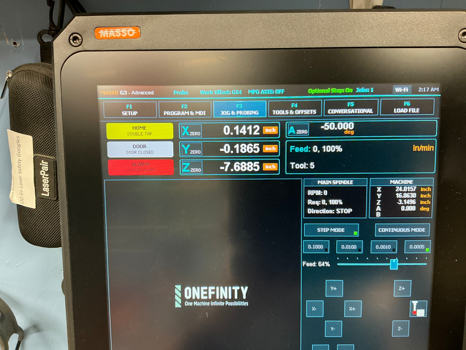

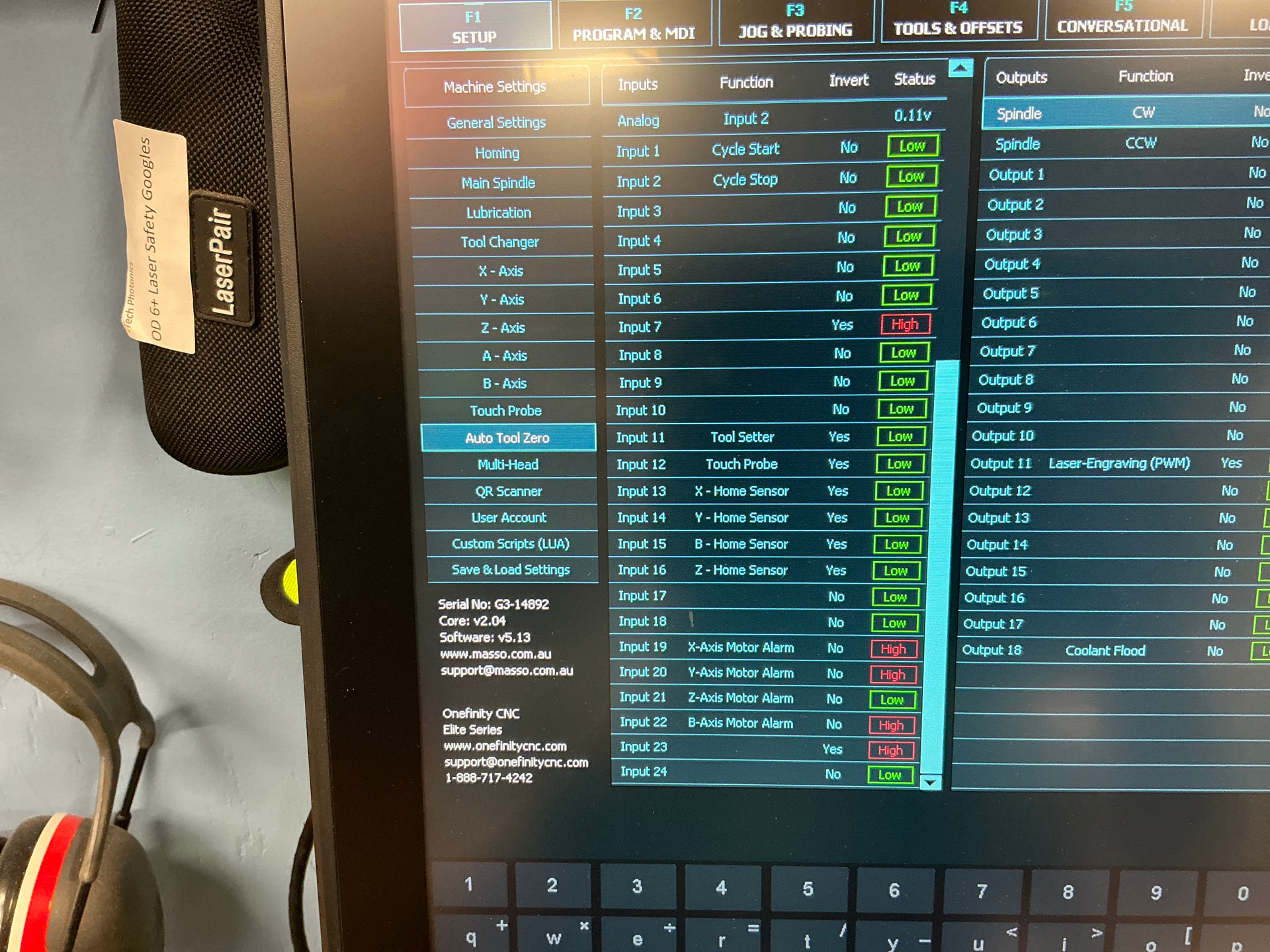

Hello,
I hope this thread is still active. After changing the power box which was defective and causing the black screen issue I’m kinda back to square one. Here’s what I wrote before the black screen issue:
“…I reinstalled 5.13 and then adjusted the switches on the motors, rebooted and did 3#. I came back with a Y hard limit alarm (and many inputs in F1 were “high”)…”
As of now here are my F1 and F3 screens:
What would be my next step?
Thanks,
I think i’m ok now… until next time I guess. Thanks,
