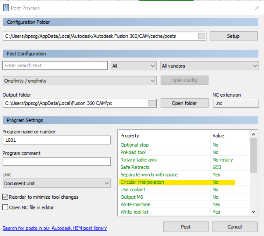

I am having trouble locating this screen. I have found the Circular Interpolation setting when I select a toolpath and chose Post Process:
Is this a version\edition difference or are there multiple places to make the change? I am running F360 Personal on Windows
I noticed that the ‘Open config’ is greyed out. Make sure you use a local post so you will be able to ajust property. On mine (same screen) I’m able to click on the property value and choose a new value from dropdown.

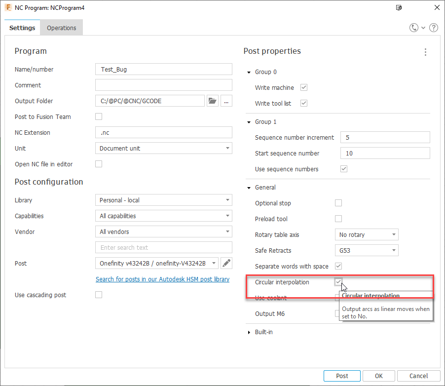

You could also choose ‘Create NC Program’ if you right click on your path then enable ‘circular interpolation’
I did a bit of research on Circular Interpolation as I was unable to find the settings within Fusion 360.
What I found was everything under Post Properties is coming from the post processor you select and not from Fusion 360. I was using an older version of the PP that did not have the setting. When I updated to the 43242, the option was available.
After Upgrading to 43242, there are two places in Fusion you can access the option, the first is when you run the post process command, the section is under Setup\Create NC Program.
I downloaded the 43242 version from the Fusion 360 website with following URL: Post Library for Autodesk Fusion 360 | Autodesk Fusion 360?
I have tested the new post and it seems to take care of the issue.
