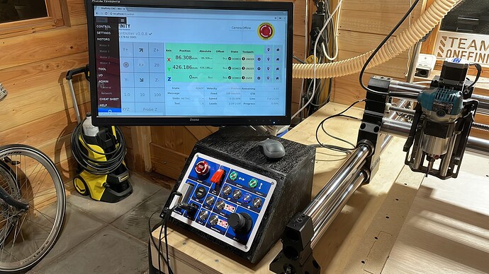

Did you load the right graphic here? Looks the same as your previous post. I’m not seeing all the labels as ALL CAPS.
Is it just me ?
I am also interested in the DIY kit.
Only the first letter of each word is capitalized :wink:

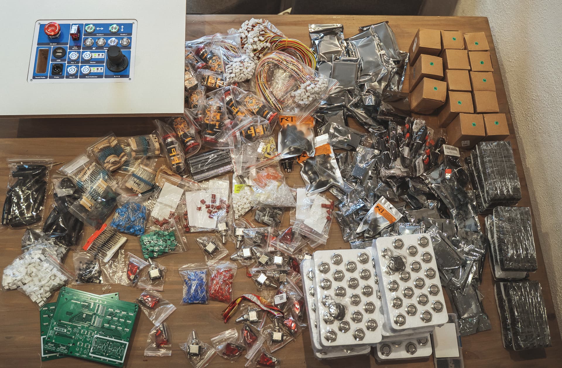

All the parts to build 14 remote control panels are in! Already build one panel for testing. :sunglasses: :+1:
Seriously underestimated the work needed to write the documentation. Building something yourself when you know what to do is a totally different ballgame then to write step by step instructions for other people :sweat_smile:. Decided to build a complete website for it.
Also made cnc cutting templates for the panel.
Still on schedule. Expecting everything ready for shipment mid November. Still not taking any pre-orders until everything is ready. (everyone who wants a kit needs to read the documentation first)

I would be interested in one of the extra PCBs that you have

This accessory would be a very cool addition to this machine. Definitely interested in the bare pcb and components as shown in the picture. Having a ton of fun with my Onefinity. :blush:

okay dear people, I promised to write a review about the control panel of Satoer. I have heard that I am the first to build a complete set. I must say that in the beginning I was a bit overwhelmed by the large amount of (very small) parts, but because of the very clear explanation I finally have a very nice controller.
building does require a steady hand to solder the small components, but a magnifying glass can go a long way. During the build I discovered that you have to pay attention to the fact that some components have to be in a certain position on the printed circuit board. but in the end a nice end result.
Looks great! Very nice. Thanks satoer for the design and thank you Cor for sharing your build photo.
