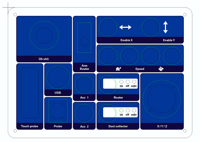

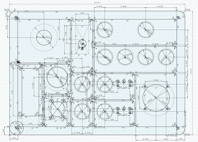

Redesigned the panel. Same layout, but tiny bit bigger. Final measurements is now 257mm x 182mm (approx 10inch x 7 inch).
Also changed the gfx. It’s neater, better aligned and changed “spindle” to “router”. Any remarks?
This looks amazing… only $.02 I can lend is on things of this nature I prefer to capitalize each word of the button labels. While proper English is great, just looks better IMO.
Oh Shit - I like Oh SHIT on that one but that’s just me. :slight_smile:
Touch Probe
Dust Collector
You already made me happy with Arm Router, but either way it looks better to be consistent.
-Alex
Agreed. Changed :+1:
It’s also more consistent now, since “Arm Router” already was capitalized.
