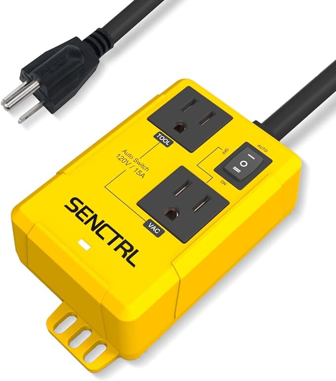

vacuum support
is there a option to turn on and off vacuum when Makita trim router is turned on
my old cnc had a plug built in the controller that turned on and off vacuum
or would you suggest the amazon option.
https://www.amazon.com/gp/product/B0BFDB9MSB/ref=ppx_yo_dt_b_search_asin_title?ie=UTF8&psc=1
the same functionality exists in the Elite’s power box.
