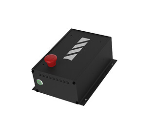

  2. Insert the usb dongle into any of the 4 usb ports in the back of the Onefinity Control Box.
